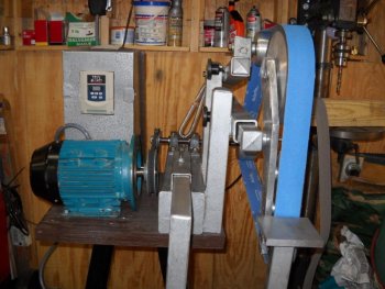

My new variable speed 2x72 grinder. Just finished building it at my friend's fab shop. (Quill Hyde, he's a whiz with design and fab.) The main parts were cut out on a CNC plasma torch, with a graphic of a snake wrapped around a torch, (Promethean Knives) I used the big contact wheel off my old hollow grinder, which meant we had to bore it for bearings to work with a square tooling arm setup, which lead to the slightly funky spacing issues you see on the attachments. It does not affect performance or ease of use however, it tracks nice and has plenty of power. That is a 3 HP, 3PH Baldor motor with the Teco FM50 VFD. It's a sensitive brute, just like I like. The VFD mount on the grinder frame is temporary, I'm mounting the VFD on the wall soon and using remote controls to keep it out of harm's way. The attachments all work great, the small wheel is just UHMW but would grind a little smoother with a rubber tire... I'm going to get a KMG small wheel fork for it eventually, though. I turned the tracking and idler wheels out of UHMW too, if it works for Bob Dozier it's good enough for me. I'm STOKED on this machine!

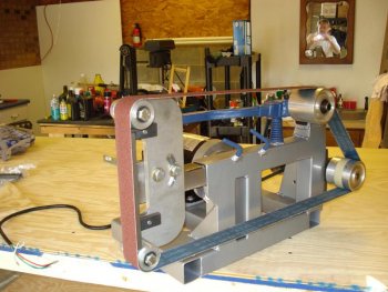

A No Weld Grinder Build by Randy Hay with a couple nifty mods..
Grinder 016.jpgGrinder 009.jpgGrinder 010.jpgGrinder 011.jpgGrinder 013.jpgGrinder 014.jpgGrinder 015.jpg
I assume you mean the angle iron on top of the belt. That is an adjustable rest for my flat platten attachment that is able to be used while the large contact wheel is in place. The other pictures show the attachment removed from the machine. Randy
I see it now Randy.
You must have your machine a lot lower than me if you can look down on that platen rig...
Cool stuff.
My machine is at table height. When I was building it on my bench, it seems to be a good height, so thats how high I made it. I think its about 30" if my memory serves me right.

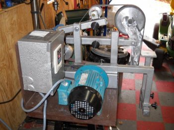

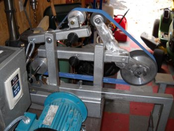

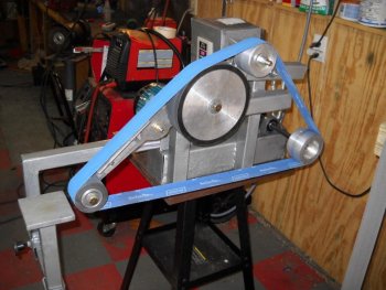

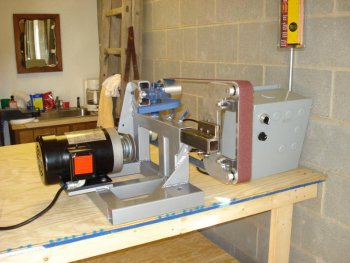

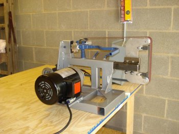

Here are some pics of my no-weld grinder. Some changes I made /characteristics:
I welded it
I modified the tool rest to adjust to any possible rotational position of the platen
I used a non-enclosed 3 hp rated VFD to power a 2 hp surplus 3-phase motor (to save money $272 for both). I put it into a home-made box that contains a 120v muffin fan wired to 1 leg of the 240 input; the inlet and outle to the boxt are covered with filter paper, and weather stripping is used at all junctions and around the protruding face of the vfd.
I used inch and a half pipe caps to cover tube end, on the outside of the small tubes and stuffed into the 2 inch tubes, outlet plates cover the openings of the main tube.
It is a fun project and I look forward to trying my hand at knife making.[/FONT]
