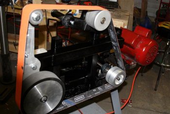

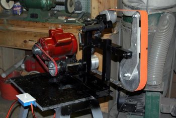

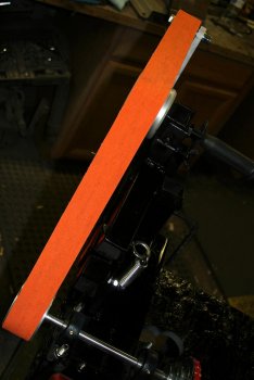

Heres my NWG I scored the frame from a KD member, The motor is a old 2 Hp that Im gona need to replace very soon. (So if anyone has a good 2 HP or larger motor for sale. Message me please) The tool attachments and multi positional platen and wheels came from Tracy! and the base is a old table saw base.. Its not the prettiest grinder..Yet it runs true and still is a HUGE upgrade from the Giz 2 X 72 grinder I have been using!
But I must admit, The Griz will stay in service for profiling and surface grinding etc.. And my old 1 X 42 Delta will always have a place on my bench!

You guys have some really slick set ups! This is a the worlds BEST tread about grinders!

I had to touch up a 2 of the welds and there were a few extra welds I kinda scratched my head at.. you know the ones! :) Either way, Im stoked and just did my 1st EVER hollow grind on a small folder blade. The thing works GREAT! tracking is true and even with the funky extra welds.. Im grinning from ear to ear like a kid in a candy store!

That looks to me like a good blade launcher . It would make me a bit nervous on anything but really thick , soft material .
