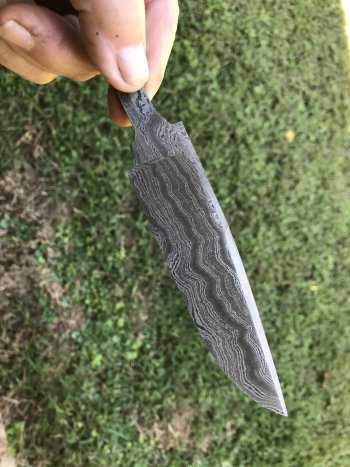

Tried a coffee etch today. I like it.
I used about 4oz of instant coffee with 14oz of warm tap water. The cheapest instant at Walmart I could find.
This is about 20 minutes of soaking.
Prep is the same as other damascus.
Near mirror sanding, buffed and wiped clean with alcohol. No fingerprints please.

Gene Kimmi
I used about 4oz of instant coffee with 140z of warm tap water. The cheapest instant at Walmart I could find.
View attachment 75652View attachment 75653
I use the exact same bottle of coffee. I’ll mix about 1/2 of it in a quart canning jar with hot water. Once done etching, I store it in the refrigerator. When needed again, I just heat it back up in the microwave. I’ve had it last more than a year that way.
