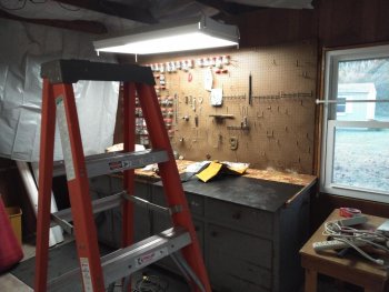

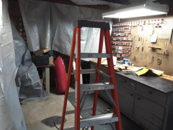

What's going on in my shop? It's a new shop! I am taking over part of the garage! First step is hanging plastic to try to keep the dust contained, and then getting tarps to cover the other stuff in the garage, which we are using for storage currently (just moved into the house in mid August and had our wedding there last weekend, so there is a lot to go through!). Just gotta make a few modifications to the plastic sheeting and I can start moving my toaster oven, kydex press, Jet drill press, Band saw and 2*36 handle sander over. Then it will be time to set up the Ameribrade FastBack and get a 220V outlet into the garage!
Belt sanders will go right on the table in front of the window. To the left will be my assembly area, followed by the kydex press and oven. Behind those will be the drill press and belt sander and another assembly table. The work table is big enough to hold my handle materials, kydex materials, blanks, tools, etc in the drawers without having everything all over the work table cluttering the area up. Looking forward to using the new shop!

Workspace is always a good thing! A couple of things to think about/remember...... Lights, lights, and more lights. Double the number outlets you think you will ever need! Lights, lights, and more lights. Make sure the bench for your grinder is two things...... the correct height FOR YOU, and attached/built into the building...making it as solid as possible. OH! And Lights, lights, and more lights. And finally, did I mention..... Lights. lights, and more lights? :)
I want lots of light! There are outlets all over the place, so I will add extra lighting in the shop as needed, which will be nice! My current shop is fairly dark and I hate it. There are 5 circuits in the garage alone and metal outlets along the wall around half of the garage, plus several in the ceiling for lights.
I will be using my home made 2x36 Franken Grinder for now and once I get the 220v to the garage, the motor and VFD setup for the Ameribrade Fastback, I will get the table height figured out and make sure the table is rock solid. I built my own table in my other shop and may move it over to the new place or build up another one. I know a solid grinder table is a must!
