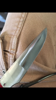

I still have to figure out my process a little better but I played around with a cork belt and compound today.
