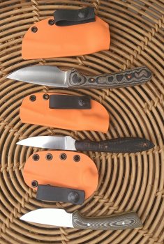

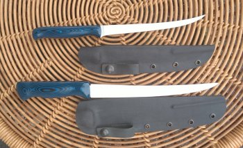

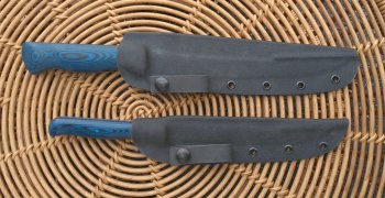

Did the handles and sheaths for the 2 fillet knives (Lauri 220mm and a 7" fillet) this weekend in the new shop and the bottom little knife in Richlite of the 3 hunting knives (CPM-154 blade). Nice to have room to walk in the shop without bumping into stuff! Gotta hang another light above the drill press/band saw/kydex area. Looking into getting my Ameribrade Fastback set up soon, too!
