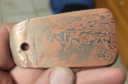

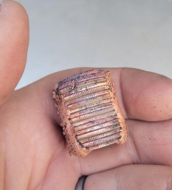

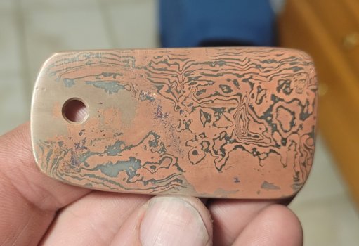

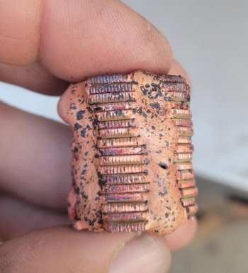

Made some Mokume last night for the first time! Stacked and Tig welded 17 quarters and forged it out. When I folded the billet for more layers, I didn't clean the surface and it wasn't not enough, so I have a seem going down the middle of the piece. Lots of fun to do, worked very easily under the hammer, too! Got it too hot a couple times, so some metal squirted out when I forged it, so I need to pay more attention to the heat!

I just hammered the heck out of it, used the cross pein to put random deeper divots in it, folded it and hammered it flat again. Was a lot easier than I thought!

Looks good! It's fun when the metal squirts out and heads towards your leg or some other undesired location!
The other downside to that is it can leave you with voids in the mokume, which lead to other bad things.

That Mokume looks good - raindrop pattern. Looks in the bottom photos you drilled some holes, then forged flat, then cleaned up? Still the stacks of quarters? I just might have to try that soon.
Taz575
Yeah! 20 quarters stacked (per stack), tig welded w/o filler rod, hammered into thick discs. The D shape ones went thinner, so I cut in half, drilled dimples in the outer surface, cleaned off the scale, stacked and re tig welded, then forge welded and forged back out, so around 40 layers. The round one was the same 20 quarters, forged down thicker, dimpled and then forged flat again. Got an inclusion on one side of the stack. I like the 20 layer look vs the 40 layer ones.

How thick are the final pieces? I've been wondering if they could be used for guards and spacers. Looks like a lot of fun to do.

The round piece was around 1/4" thick or thicker before I dimpled it. I went deep with the dimple, so it was a touch over 1/8" forged flat and is around 1/16" after grinding some inclusions out. If you forge to half inch thick, dimple and then flatten, you should be able to get 1/4" thick piece for a guard easily. The D shaped ones are around 3/32 or 1/8" thick roughly.

Mokume Gane is cool to make and easy with quarters. Those rain drops turned out great!
My next attempt I'm going to try and get some brass mixed in with the quarters. It's tricky though as the brass melts at a lower temp. Gotta get my thermocouple working today.
