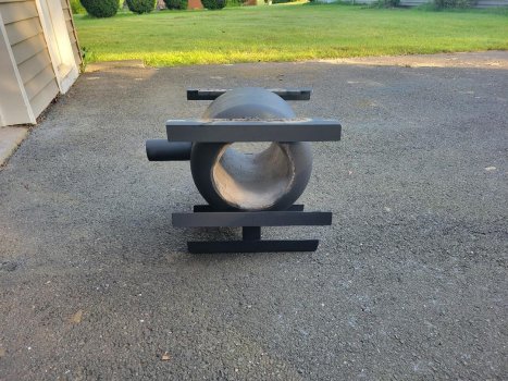

If you need any guidance as far as stick welding goes, just ask! I've been stick welding for a lil bit.Got my forge done! Also picked up a YesWelder TIG 205DS and have been trying to learn stick welding with it until I get an argon tank to go to TIG. I got to try my buddies MIG welder and did pretty well once I got an idea of how it worked. I am doing OK with stick, but having trouble starting the weld without sticking the electrode to the metal.
Crank the heatI used Forber 3/32" 7018, tried 80-100 amps, sticks bad every time and its hard to lift away to start the arc. I am going to try it on 220v tonight and see how it goes.
Gotcha. If you're running on 120V, I suggest bumping the amperage up a bit higher and see if that works (maybe 110A?). If that doesn't work, forget about 7018 on 120V altogether. 110A is a LOT for a 120V circuit. Get some 3/32 6013 and try that.I used Forber 3/32" 7018, tried 80-100 amps, sticks bad every time and its hard to lift away to start the arc. I am going to try it on 220v tonight and see how it goes.
