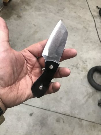

Spent some time trying to teach my self to forge, I have not done all that much and decided I really need to work on just basic skills so made a few blacksmith mini knives, hooks and a fire poker. I enjoyed making the hooks and fire poker better then the knives I felt I struggled to get the shapes I wanted....guess that's what grinders are for.
