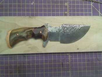

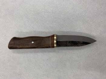

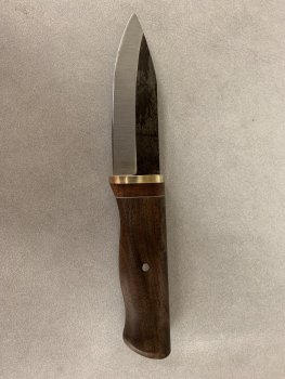

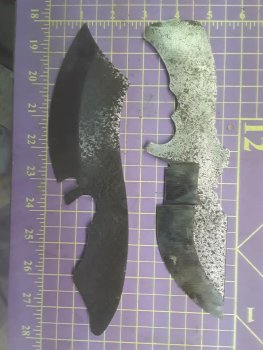

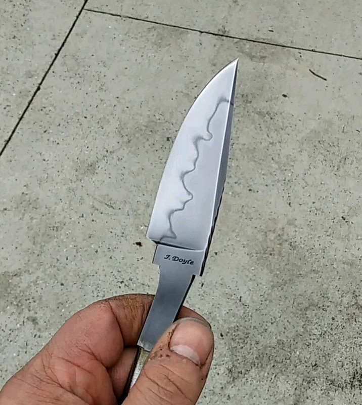

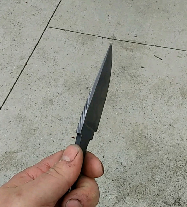

Got a couple closer to done today!! A Gen2 Hunter in Mosaic/410 San Mai. And a big..... big..... I don't know exactly what to call it.....but I like it!
The hunter is fresh from cooling after baking on Clear Satin Moly Resin.

Very nice!

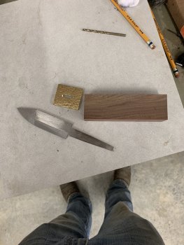

Here is my homemade scribe. It's not pretty and I still need to lap the face of it on my granite block to get it perfectly flat but it works an I have a total of $4.97 into it(bought a carbide edge pen scribe used the tip)
Ahhh, Very Clever, Can I steel your design???

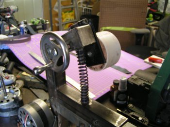

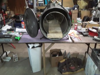

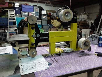

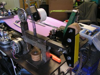

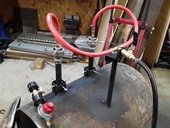

I am working on several blades ATM, a diy Forge, (Just built a small very inefficient forge) and a 2" x 72" grinder, oh and sheaths for two of the builds. Man I wish my boss would have waited one more week before calling me back! lol.

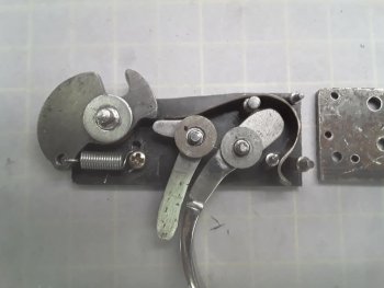

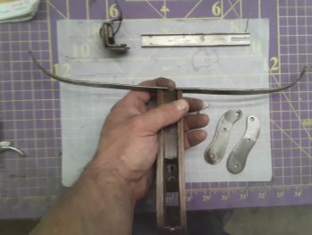

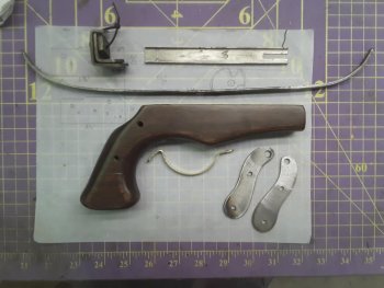

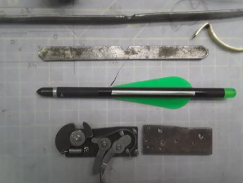

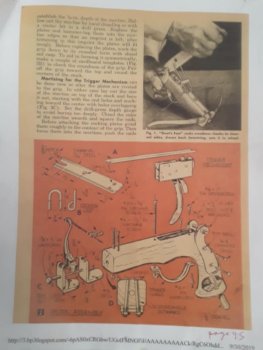

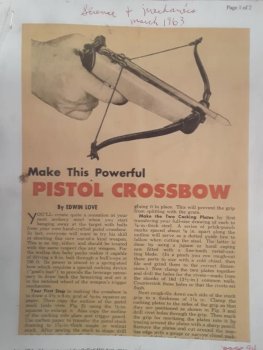

Oh yea, I forgot about the Pistol Crossbow, My wifes doctor's Father started this project back in 1963, found it in Science and mechanics magazine, and he wanted to know if I could finish it, well we are getting close, completed the trigger mechanism, blued the steel parts, putting it together is a challenge though because a lot of measurements were changed, by mistake or better design? I don't know, but I am having to re-engineer some parts to get it to fly. The Bolt is made from a carbon fiber Crossbow Bolt / Arrow, It may be too light to fly straight, and will have to remove the fletching.

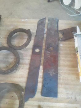

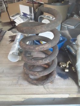

Also I have some Mystery metal to forge some blades from, a couple lawn mower blades, and some coil springs!! I don't know if they will be satisfactory or not, but it will be fun learning! I do have a shipment of 80CRV2 steel due this afternoon, I can't wait!
