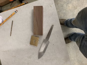

Finally got out in the shop a bit. Working on this knife that is really mostly John Wilson. However any apparent mistakes are all mine.
The blade is from John, already profiled and heat treated. All I had to do was grind the edge. The walnut is from John also as well as the brass pins.
Maroon-red G10 liners are from USAKnifemaker.
Although this is a fillet knife design, this will be for my wife for use in the kitchen. One thing I'm experimenting with is putting Tru-Oil on the front of the scales before mounting. I figure this might help things a bit. I always have trouble keeping the front of a scale or a bolster all cleaned up. So I'm hoping this will prevent that.
I like this design/ I intend to make another one for myself to go fishing with later this summer.

Sean, you’ve done very very well on that! That is far from an easy grind and you’ve pulled it off really well.
I also put tru-oil on the fronts of the scales before I mount them.
Fillet knives are extremely useful in the kitchen. I use one all the time.
Sean, hopefully you made a template of the blade and your scales. This design is a good seller for me. You should have no trouble selling a bunch of them. It’s hard to find handmade fillet knives. They bring a good price.

Thanks John. The grind was a bit touch and go at first, but I went slow. This is the first time I've put tru-oil on before mounting and I'm planning on continuing to do so.
Thanks again.
Yes I made a template of the blade but not the scales. I've been fitting scales as I go. But that's a good idea. I will do so before I go any further.
I haven't sold any knives yet, but that's encouraging news. Thanks again!
