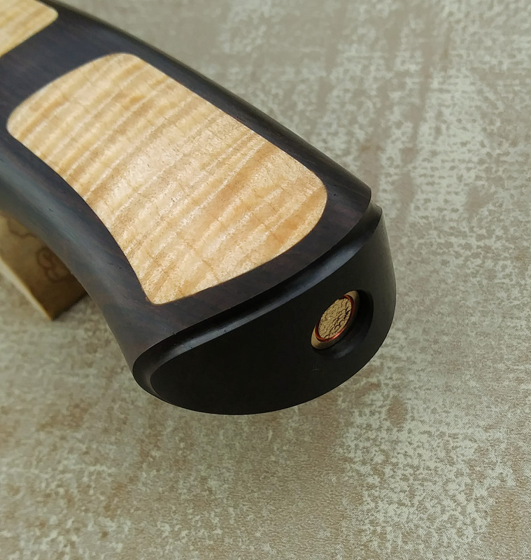

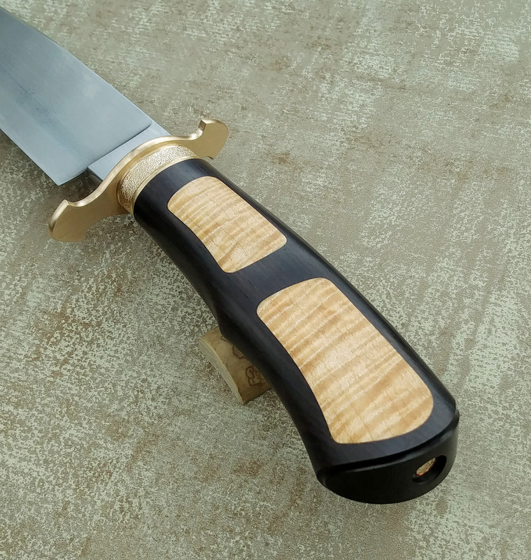

Randy, y'all sure do git some nice results from that exotic handle material.I have this one in progress. Still have some sanding and polishing to do but I’ll finish it up tomorrow.
Beautiful! I have some of the same micarta and would love to get the same finish. Would you mind if I ask how you got that finish?I have this one in progress. Still have some sanding and polishing to do but I’ll finish it up tomorrow.
It’s so tuff it can be a challenge to get a good finish. I’m still experimenting with it but it seems to be getting better. Sand to 1000 grit sometimes it takes 1200 grit. I put it in a jar of teak oil and soak overnight. Clean and then buff with denim. A good long strip of blue jeans and “shoe shine” buff it vigorously to build some heat. It won’t take a high shine but will be very dull otherwise. One problem I ran into were white specks. Might be sanding residue getting down in the pores. Only way I could fix it was with a very thin layer of super glue. I sanded all the glue off but it filled the pores.Beautiful! I have some of the same micarta and would love to get the same finish. Would you mind if I ask how you got that finish?

Awww quit whinnying DeMo. J/K it can be a chore but I try not to get too many stacked up waiting on hand sanding. Having said that I’ve got four on my bench waiting on me to sand. That’s why I’ve been painting guitars today.Time to start the hand sanding. Ugh!!
