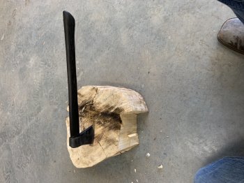

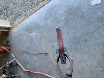

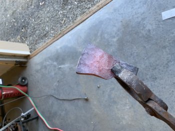

Another wrapped eye hatchet .270 thick 1084 with an additional piece of 1084 forge welded in to add mass to the bit. Hoping to get it mostly finished after walleye fishing with my Grandpa tomorrow
