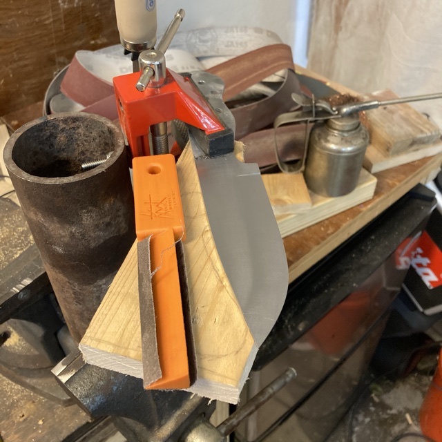

So I have started my draw filing and then went to hand sanding. Learning one thing for sure - ol' Bruce knows what he is talking about - use the brass and keep the files clean! I THINK I am about ready to heat treat this wench of a knife - any thoughts?
Dunno why everyone puts wood and stuff inside the pipe? I attached a small vise head I got in a box of tools from an auction - I can twist and turn in every direction.
Sanding Sticks? Thanks Ed!!

That blade it's looking good, very impressive! And, I like your tool fixtures, creative and functional.
Thank you sir - I am trying to make my best blade. And I love pidlin' with stuff and making it work for me... Appreciate the encouragement!

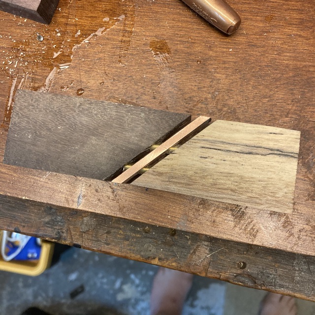

So, didn't really like the initial handles - too plain
So I am trying something - here goes nuttin Bruce!
Texas Ebony/Spalted Texas Pecan - Copper spacer double pinned - we shall see

I agree with John. Hidden pins require critical layout, not only in the profile but also any contours you put on the handle.
In a handle layout like yours, I probably wouldn't do hidden pins. I would drill some holes through the copper spacer, which requires the same critical layout, and use a good 2 part epoxy to put them together.
Cain't ya incorporate the mistake into the design of the knife? Think, Gloria, Think!!!
Make the pins visable? Might be cool
No, I think it will look like a glaring mistake.....with all due respect.
I think biting the bullet and starting over is absolutely the right call.
Wow - thanks for weighing in guys! I learn so much from all of you. As for the handles - I'm a startin' over..
Maybe 'with purpose' (as I believe I recently read on this forum) some pins coming in from the bottom of a handle might look good - but not as a cover up - I really suck at this and need to learn to plan mo' betta... I can use the practice - thanks again for helping an ol' pidler on his journey!

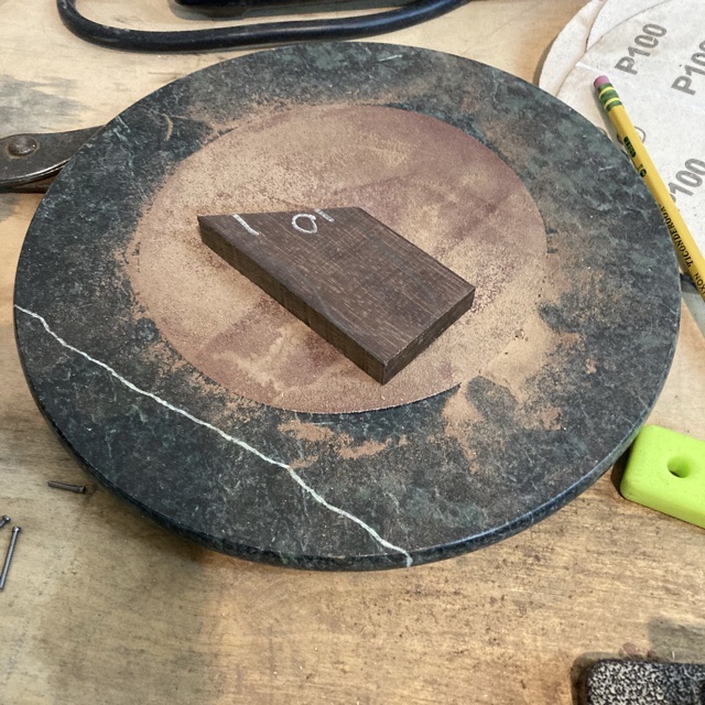

Back in the shop (garage) last night for a while. Got new scales cut outta my Texas Ebony and Spalted Texas Pecan and got 'em flattened out on my lil ol' piece of granite.
Now - can someone tell me the secret squirrel code for drilling a stupid small hole at a 40* angle through copper - without the stoopid bit walking and breaking? Preferably before I go wheelin' - with my drill press being drug behind my jeep...
