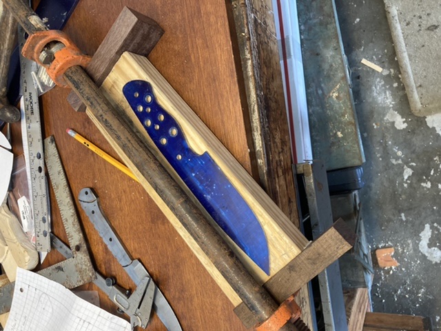

So my correct sized drills came in for the pins I decided to use. Drilled them and some balancing/epoxy holes. Question - is there a preferred 'balance point' on a blade such as Ol' Hillbilly's here?

To my way if thinkin (or NOT thinkin !) the balance point should be at the ricasso. But, wadda i know1
Here is a rudimentary drawing about how I place pins. This is a knife with a bolster. You need to adjust if you do not use a bolster. I place two pins in the bolster in the center of the knife. I use a caliper to find the center and scratch indication lines on blue dykem. On the scales I measure the length of the scales and attempt to keep the pins evenly spaced apart. Again caliper/blue dykem. From the outside edge I come in .200 to .300. I use 3/32 pins, usually. Larger pins necessitate coming in farther from the outside edge. If you want, you can run the pins down center of the blade. Pin placement should be pleasing to the eyes...
When I make your knife, you get two pins. And I’m being generous.
Real difficult to balance full tang knives under 4 1/2" blade length or so. You'll need a distal tapered tang and lighter weight handle material, like natural wood. JMO.
That was my thought T = I dunno about 'balance' on a 10" knife....
....then when you get out at about 7" blade the problem flips the other way...nose heavy.
Yessir - it felt 'nose heavy' - but I am thinking that is just a perception or preference - any 'empirical' data on 'nose heavy' or 'balance' of a knife? I think it is just 'blade smith speak' Something sop the old timers can 'gig' the noobs with
On pins, I literally draw (sharpie or silver streak) the top of my scales and pin holes on the tang until I like the way the placement looks. Then I drill it. As far as balance goes, in a handmade blade it is an important feature because to a large extent you can control it and it can make a blade (especially a big blade) feel light in the hand. I am no expert and I am sure there are better ways but I control my balance point using the tang and handle material. I do not worry a lot about balance until I have completed my blade (all the way through hand sanding). At that point I know the blade end is not going to get any lighter (or heavier) so I can plan my handle from there. If it is handle heavy, I will move my balance point forward (toward the ricasso) by grinding (or filing) a taper into my tang. If the knife is blade heavy I will attempt to move the balance Toward the handle with my handle construction. In this case I do not taper my tang and I may choose a heavier handle material like stabilized wood or micarta. Maybe I will add a brass bolster etc. I used to taper every full tang knife I made because I like the looks of it but I found that in the end, I may well get a handle heavy knife for my troubles.
In short, when I start my handles, I like my knife to blade heavy by exactly the amount I guess-timate my finished handle will weigh. That way my balance point almost always ends up right around the ricasso/top of scale area.
Visual balance of the knife is another story. I do all of that by what looks right to my eye. Pin placement, handle size/length compared to blade size length...all visual.

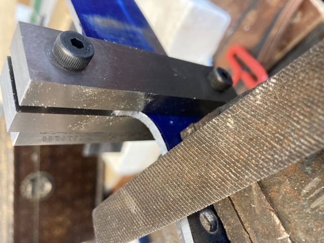

So re-did my jig a bit so I could use my file guide (just cut a slot in an old tv stand door) drilled some holes and attached that piece of brass ol' HillBilly sent me - ( Thanks Bruce!) so's I could try and keep my file clean.
Observation: This steel that I ordered up - it doesn't create near as much chunks of scat as those old files do - maybe because they had been hardened 50 years ago - and then annealed by an amateur like me?
