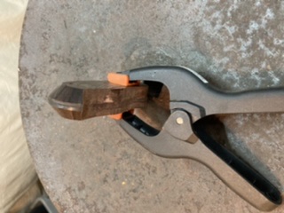

So re-did my jig a bit so I could use my file guide (just cut a slot in an old tv stand door) drilled some holes and attached that piece of brass ol' HillBilly sent me - ( Thanks Bruce!) so's I could try and keep my file clean.
Observation: This steel that I ordered up - it doesn't create near as much chunks of scat as those old files do - maybe because they had been hardened 50 years ago - and then annealed by an amateur like me?
Finally - after all this time - I am starting to file the bevel in ol' hillbilly's knife - and starting to covet some of all ya'alls' (all ya'all's is plural-possessive for ya'all) grinder skills...
Did some preliminary shaping on the Texas Ebony handles before beginning the bevels - still have work to do.

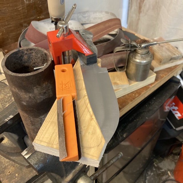

So I have started my draw filing and then went to hand sanding. Learning one thing for sure - ol' Bruce knows what he is talking about - use the brass and keep the files clean! I THINK I am about ready to heat treat this wench of a knife - any thoughts?
Dunno why everyone puts wood and stuff inside the pipe? I attached a small vise head I got in a box of tools from an auction - I can twist and turn in every direction.
Sanding Sticks? Thanks Ed!!
If you don't zoom in - it looks great. Kinda like me - I'm not fat, your too close - at 100 yards I look to weigh a buck 80 - just sayin...
