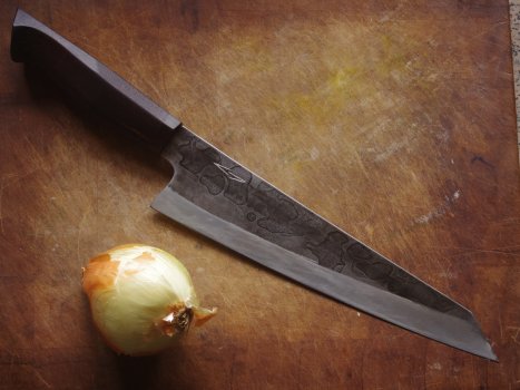

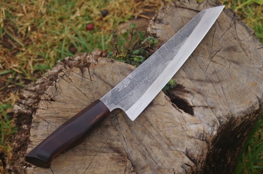

A lot of the guys here use light boxes. I like taking photos outside mostly on cloudy days or early late hours. Your type knife would look good in a woods or rocky staging.

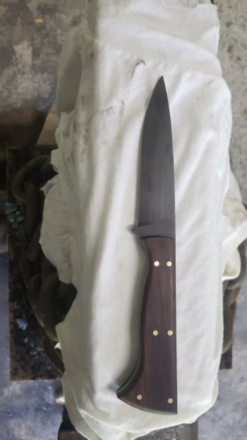

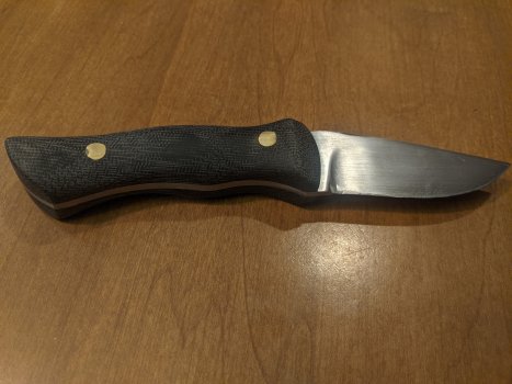

here's another picture of a knife I am working on how can I improve.

For this one, here's some of the major things I see needs improved upon as far as the knife goes:
- pins: looks like they were peened so they have an odd shape on the face. Also, looks like you didn't fully sand them flush. Next time, try not peening but only using epoxy instead, and grinding flush with a hard backing (so they don't sit proud.) you will want them to have a consistent grind direction across the faces, so they match each other, whatever grit you finish with.
- blade: looks like some divots at the base of the plunge that need fixing with grinding. I also see scratches on the blade that should have come out with hand Sanding. Also, how are you hand rubbing your blades? It looks like the grind lines are getting washed out pretty good so I'm guessing maybe just with your thumb behind the sandpaper? Next time, try a hard backing behind the sandpaper, should help
I hate hand rubbing, and barely do it... I'm no expert on hand rubbing so take it fwiw (I have done a fair amount of research though) I did these to 800 grit recently. This was done with the paper wrapped around a piece of steel bar (only 1 layer or you will get more wash out). Then after it's done you go back to the granite plate to touch up the flats and make sure the transition is crisp.
