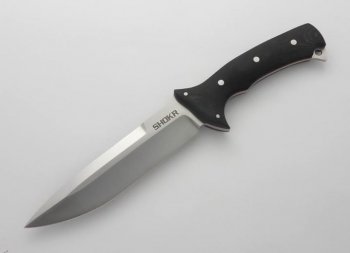

Shokr, it's hard to find a lot of fault with your series. Maybe some different choices in lighting but few faults. The dagger balanced on the shell if a fantastic picture.
The biggest thing I see is on most, one end of the knife or the other is quite a bit sharper in focus than the other. You are shooting at a fairly low angle and that requires a larger depth of field. You can put more light on it for a smaller aperature or go with a slower shutter speed but the easiest is to shoot them from less of an angle, effectively shortening the depth of field. I'd also give them just a bit more saturation to juice the colors a little more.
composition and cropping are perfect I think.
nice shots all the way.
Rudy,
bright lights are good. Cameras like them.
Learning to take great pictures takes a lot of time and practice but it's money in the bank if you sell at all over the internet.
Your picture could have the knife centered a bit more. The large black area above the knife really seems out of balance with the under the knife.
