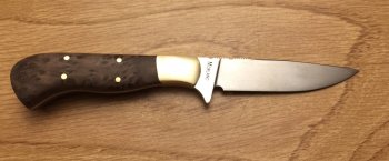

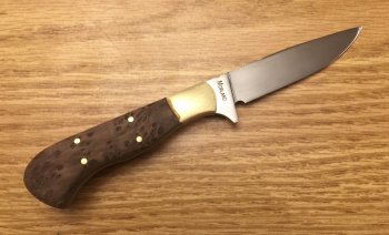

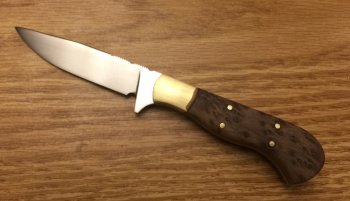

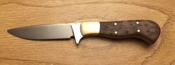

I got an hour or so in the shop tonight. Rough shaped to 80 grit. Lots of handsanding to go. John Doyle if you are following along, thank you for the redwood. It is going to be a killer handle. I did notice with all the sanding a pin is starting to show. I can fix that. Also a small crack just behind the bolster on the name side. I can fix that also. Keep moving forward.

That knife is looking terrific!
