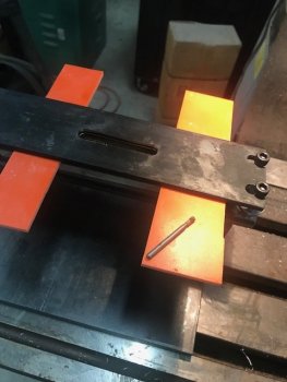

I've been working up a fixture to cut inlays. This is the rough mock up and the fixture will need plenty of tweaks. A lot of slippy guys use something like this for shield inlays. This one is scaled up for larger inlays and to hopefully cut the plugs for the inlay pocket.
The top plate is the pattern. The cutter is lowered and the plain shank that is the same diameter of the cutter runs against the pattern outline. The two orange pieces are just spacers to get the pattern plate off the test piece g10 I am milling. The whole assembly is fairly hefty but slides around easy enough. It needs to be heavy so the cutter doesn't kick it all over the place and minimize chatter. The process is to lower the cutter into the material and then hand push the whole assembly around the pattern milling your pattern into the stock. Any stock left in the middle of the inlay pocket is milled out using a larger mill keeping the cutting edge away from the pattern. It's awesomely dangerous. Here I am using a worn our dremel cutter to test this out. It works decent enough. Now I will cast a positive from the pattern using Cerosafe and figure out how to hold the positive pattern and then cut the plug.

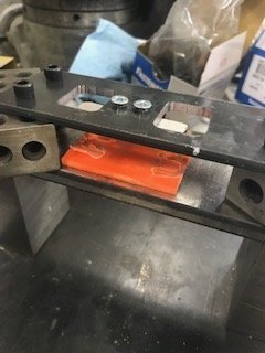

The positive pattern and g10 slug or insert material. The g10 is super glued to the support plate.
69241
This is how it goes on the mill. you lower the spindle down and move the entire thing around the positive pattern. The cutter shank smooth part is used to rub against the pattern.
