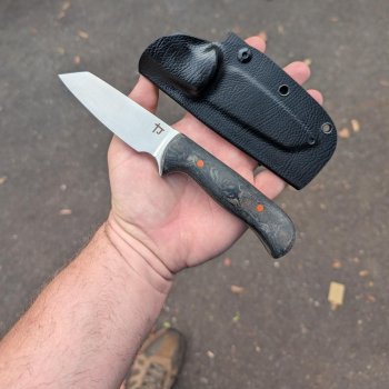

Can I get more information on this knifeHappiness is getting some shop time in! Got these 6 finished up this past week!View attachment 85070View attachment 85071View attachment 85072View attachment 85073View attachment 85074View attachment 85075

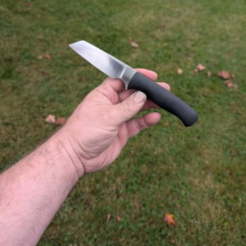

Can I get more information on this knifeAnd more shop time! Funky Orange/Green fabric handles for a Nitro V paring knife, Oyster knife (premade blank on the Oyster knife), and CPM154 fillet knife. Black micarta for a Magnacut FBBO reverse tanto and Orange Amerigrip on a Magnacut Hunter/EDC.View attachment 85117View attachment 85118View attachment 85119View attachment 85120
