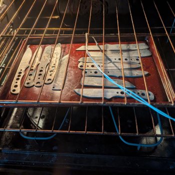

Used my oven for stainless finally! 10 Magnacut blades and 2 AEB-L blades heat treated and cryo'd at home!! Process went well using the foil packets and then the nitrogen. Tempering took a while because I was creeping down on the HRC numbers (Magnacut was 63-65 after the first 300 degree temper, then up to 65-66 after the 2nd temper, AEB-L went to 66-68!) to get them to 64 for the Magnacut and 63 for the AEB-L. Minor warping, but the carbide hammer took care of that pretty quickly. My LN Dewar has "specimen holders" that will fit a blade just shy of 1.5" wide into, so I loaded up 5 blades in each holder for the cryo process, so I didn't clamp them, just put them in...slowly. LN boils fast if you put them in too fast!

And that brings up another question! Stainless foil pouch, 1975 for 15 minutes, PLATE QUENCH, then cryo, then tempered at around 375 to get down to 62-63 on what I thought was AEBL. So it looks like a plate quench in a foil packet worked on the carbon steel????
What carbon steel was it? I’ve done that with air hardening carbon steels
