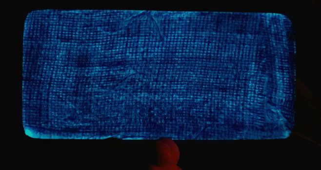

Yeah, I have some vacuum stuff incoming to try. The fabric like denim and linen is beautifully solid with the 6 ton press. Burlap and carbon fiber seem to need less pressure and more epoxy/better saturation.

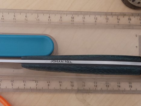

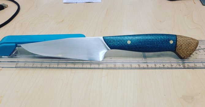

I finished this knife. I found out just how difficult it is to etch 15N20. Due to it's high nickel content, the photo positive technique does not work well for etching your logo. It took multiple failures and a final etch period of over an hour to get a decent etch. Then the logo happened to be ever so slightly skew....
This knife is a prototype, so now on to testing it.

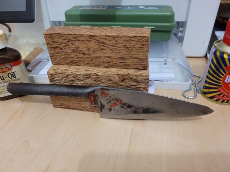

Next up is this 'knife'.
It's a bit tongue in the cheek and meant as a knife to be used on the barbecue (braai). It is one of two pieces of an old sheep shear. The two pieces had separated and is quite old and well used. Not the best material for a full fledged knife, but it takes a good edge and works well for its intended purpose. It is also an interesting conversation piece.
I need to attach one of those palm tree blocks for the handle.

That is a lovely knife!
