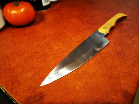

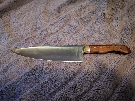

Randy, what thickness are you using for the chef's knife? I just gave my brother one (kitchen chopper, first pic) that I made using 0.125" AEBL. Not sure if that was a normal thickness to use or not for a chopper. Did another just for me in 0.093" AEBL. That works really nicely.
Hi Adam! I'm new to making kitchen knives so I'm still experimenting with thicknesses to figure out what I like. I used .074 ABEL on my first chef knife and a set of steak knives. The set of ten that I have profiled are a little thicker at .100. I heat treated three of the steak knives yesterday so we'll see how it goes.
