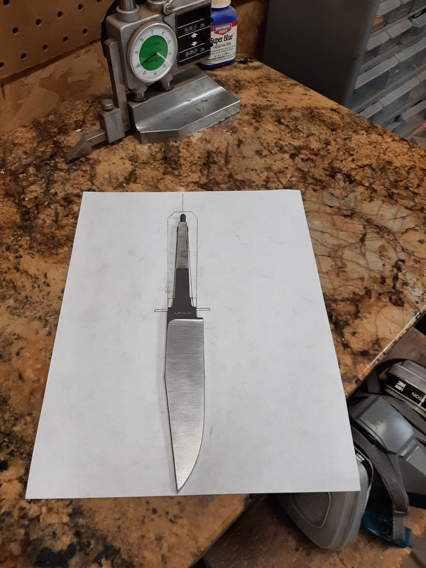

For the last few weeks I have been tinkering on a new knife in the shop but I only have a pile of bad parts so far.

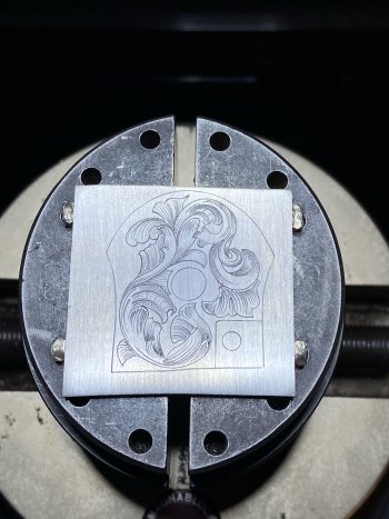

Most of my time has been practicing engraving lately. Here is my latest practice plate.
I have two knives I need to engrave. This design practice will be the one I use for the front bolster on one. This will go on an auto with button.
By far, the hardest part of engraving is design and drawing. Most evenings I work on sketching for at least an hour while ignoring the TV. I use an IPad, Apple Pencil and the app called Procreate. This is the sketch for the engraving above. I use a full page print out of the sketch for reference as I cut.
Here are two earlier versions I chose not to use. The one on the lower right is a deep relief version which is not that fun to do.

For folks who don't engrave..... those pics above represent a significant input of time and effort. Background removal is a task that I despise. :)
