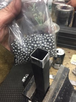

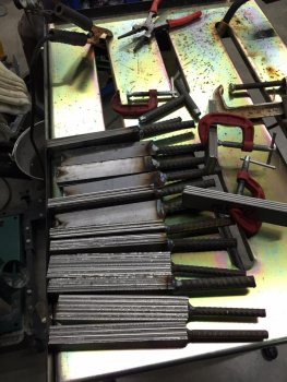

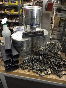

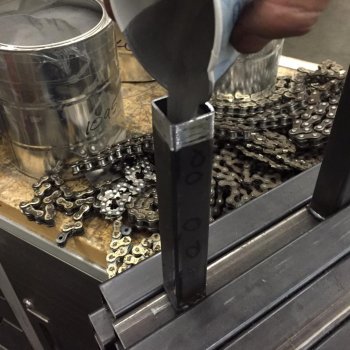

Getting some Damascus billets and cans ready for the hammer in...
