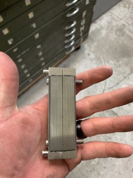

That is pretty much how mine is set up. Throw them in, tighten the vise. Shoot compressed air in the crack although I'm not sure the air is needed.
For those that don't recognize it, these are wood vises. The aluminum plate has to be bolted onto the vise "jaws". The small hole you need to make is not an issue.
Got my quench plates today from Tracy. 1X4X16. Mounted in a vice and ready to go. 154-CM and 440-C from Aldo is supposed to be here tomorrow. Ready to see how much stainless steel I can mess up. :)

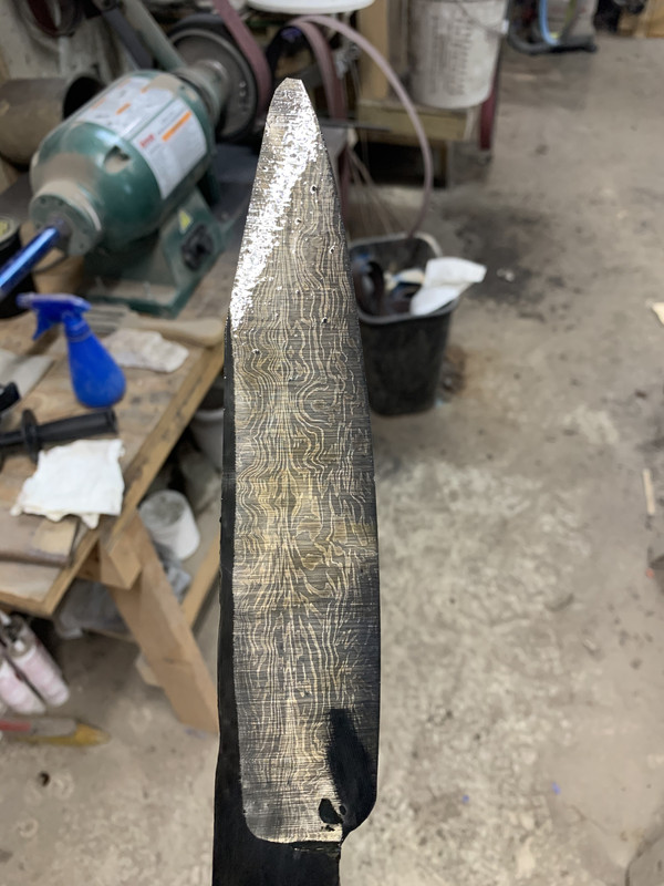

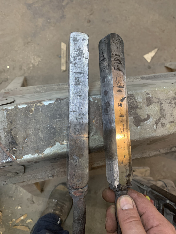

I've been working on making more damascus. This is 2 billets of crushed w's.

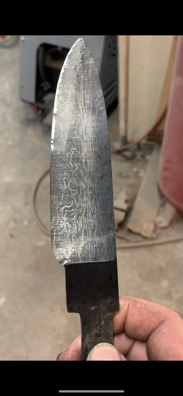

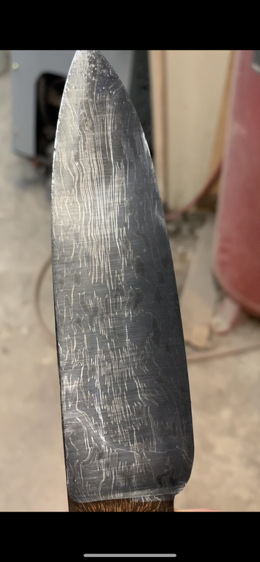

I really want to get the feather pattern figured out. This is a bowie in crushed w's feather pattern. I think I'm crushing the w's too much.

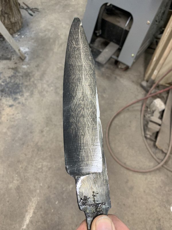

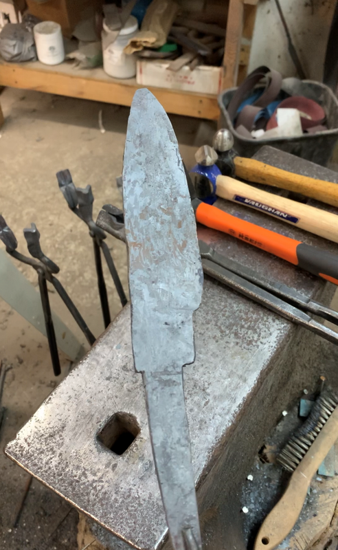

Since the feather didn't turn out how I wanted, I made this one out of the crushed w's.
It is probably the best I have done in forging to the final shape. Way less grinding to get it cleaned up.
