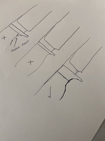

One thing I see a LOT of people do when they fit handles up is illustrated in this drawing. If people have a radius leading into the guard, many times the handle material has a radius “feathering out” onto the guard material. That’s the top two drawings. I have noticed that the handle material tends to chip off where I have “break point” labeled on my drawing. The handle material tapers to nothing, so even if it is epoxied together, it damages, wears, and breaks easily. I make mine now like the lower illustration. The handle material stays perpendicular to the metal guard, and is much less likely to break. I think it looks nicer too.

CDHumiston
Very nice example for my future guard projects. This is my first.
