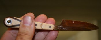

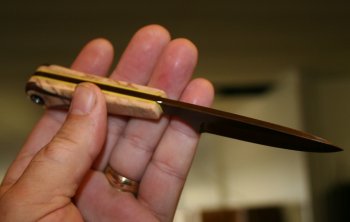

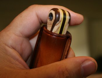

My blades are all A2...love that steel! But I see on some sites that guys don't care for the patina that develops since it's not a stainless. (with a fair amount of chromium it does take a while to show change) This morning I decided to try a quick experiment using Mark Lee Express browning #2 solution. I LOVE it...puts a forced patina that I think will last. What do you all think?
I did not clean the steel..just did a quick alcohol wipe...and there are a few spots that didn't "take"...but I think it is worth playing with a bit further.IMG_1932.jpgIMG_1935.jpgIMG_1937.jpgIMG_1947.jpg
