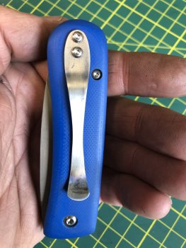

Working on my first folder with the help of Chris Crawford of Chris Crawford's Knives. Chris' website. He does some amazing work and has been extremely generous with his time and knowledge. Check out his website for some very good tutorials. I know a few of you have made an etcher using the plans on his site. I've ordered a rise and fall indicator from Boss Dogg that should be here tomorrow. Looking forward to making progress on this.

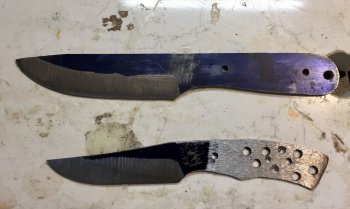

Today’s work ready for HT. Both will be plungeless so I am not worried about the waves in the lines. Why plungeless? Because I can mainly but I wanted to experiment with looks a little.
