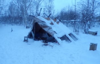

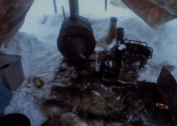

I've been fighting weather and wanted to get somewhere in my heat treat... I built this little tent to harden my knives in. It'll keep the snow out of my oil and be a little warmer inside.
I'm experimenting with wood charcoal still. Using draft to create/control airflow and temperature, firebrick to isolate the heat, and have a thermocouple in there to measure temperature.

That's pretty hardcore. And here I've been grumbling about the cold in my garage.

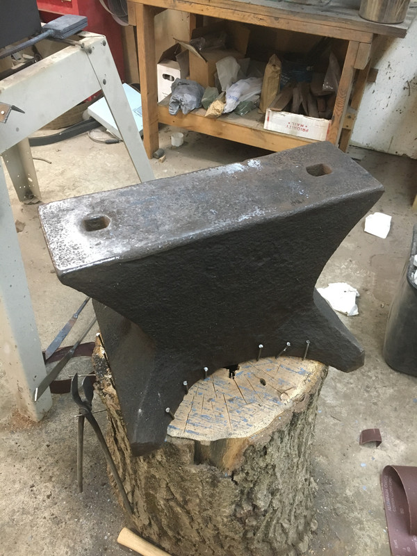

I picked up ( not literally) a new to me anvil a couple weeks ago. It's a 327 lb hornless that was imported from England. It has some pitting, but I'm in the process of cleaning it up. It has a 6" X 19" face and is a perfect fit in my smaller shop.
I went ahead and forged a couple out on it. A 39 layer twist damascus and one out of 1075 that I'm trying a hamon on.

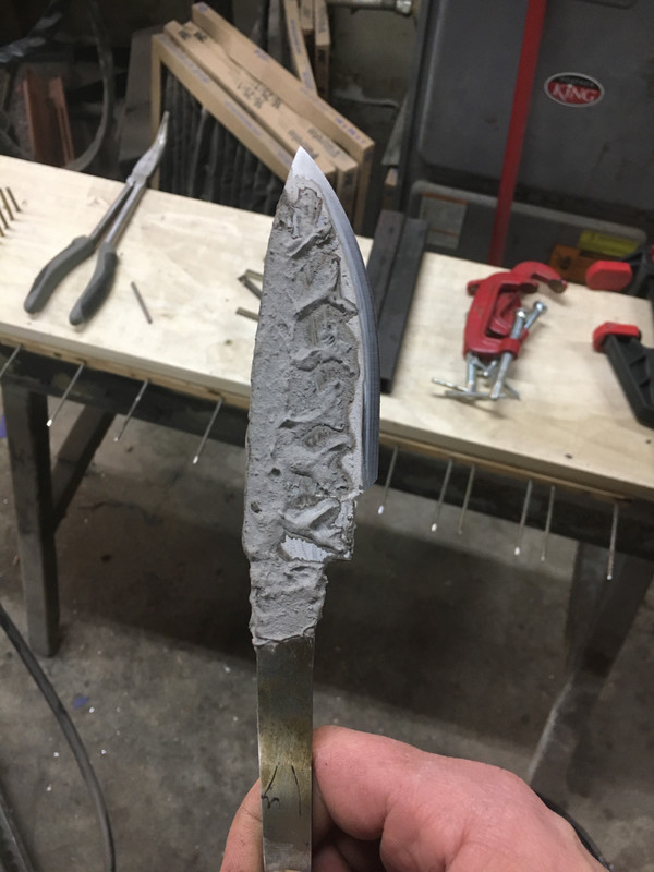

I could be wrong on this but I think your clays way to close to the edge. I always heard that you want your clay a good little bit back from where you actually want your line. I’m afraid you’ll end up with a soft edge left as it is now. But please check with somone that has done Hamons. This is just based off of research I have done.
Ps. That anvils a beauty!
