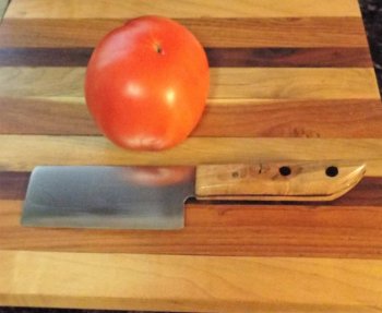

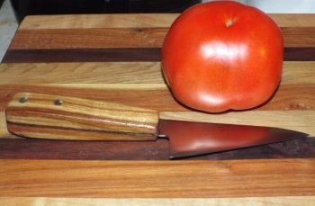

finished a couple of kitchen knives.
8" overall length with 4" blade. canarywood handle.
8" overall with 4" blade, hard maple handle
Both blades, 4 1/4" long, 4" cutting edge, are 0.45" thick at the spine and 0.003" thick at the edge. 1.2519 high carbon tool steel ((C:1,15%/Mn:0,4%/W:1,4%/Cr:1,3%/V:0,25%) hardened and tempered the blade to a final hardness of Rc64-65, The edge was then ground to 8 degrees per side then hand worked to razor sharpness.
