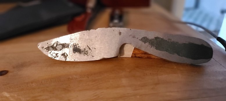

I got my new belt grinder more or less dialed in. It's a shop-made 1X42.
I'm going to finalize the tensioner design (switching to a gas spring), add guards, get the platen like I want it, and get it all painted then I'll make a dedicated thread about it. Gimme a week or so.
I incorporated a couple design elements that I think are fairly novel. I'll share that in the write up. The main one being that both of the idler pulleys are adjustable for tracking to compensate for any warp or twist in the frame (I plasma cut and welded all of it). It worked well.

Anyway... I am using the same belts I had with my old 1X42, I grabbed a 400 grit on accident, when I meant to grab an 80 grit (same color and brand. I was distracted wasn't paying any attention when I grabbed it). I used it for about 10 minutes and never noticed.
With a 400 grit belt, it is AT LEAST twice as fast at removing material than the old grinder with an 80 grit.
Edit; still planning on making the BIG belt grinder. I made this specifically for sharpening knives and tooling.

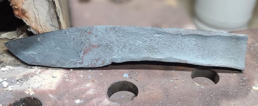

Forging my 2nd hand forged blade still a lot of learning but I have figured out a few things. Didn't have a design in mind just started out by trying to hammer in the point as best as I could.
Nice!
2 bits of advice:
Bit number A - Get a steel wire brush with very stiff bristles. You can use that to knock the forge scale off the work piece as you're forging. The scale comes off a lot easier when the work is still up to temp.
Bit letter 2 - be careful when you're drawing out the tang or forging down the width of the stock in general. As you hit the narrow dimension of the stock, be sure to turn to the wide dimension fairly often to keep your stock relatively flat and to keep the stock from "mushrooming" out too much.
Good job on forging the point out. If you're not careful, you can get what's known as a "fish mouth" and that can end up as a "cold shut". (See picture) It's where the two points of that end of the rectangular stock fold into each other.

Thank you for the advice sir. I have a wire brush or two just didn't use it often enough obviously. I also did what you suggested on tid bit #2 but still had the issue of mushrooming. I cut the point in the last bit because I was starting to get the fish mouth you mentioned.

No problem! Skip the formalities, though... dude-man.
Another bit of advice: Rounding hammers! All a rounding hammer is, is a hammer, with a radiused face.
Not a tight radius like a ballpein, but not flat like a normal sledge. The radiused face helps you move more material per blow.
I also radius the edges on all of my forging hammers. Those sharp edges that they come with stand out like a sore thumb on forged pieces, plus sharp corners are stress risers.
I'll take a picture of my "go-to" hammer next time I'm out in the shop. It's a 4lb sledge/rounding hammer.
