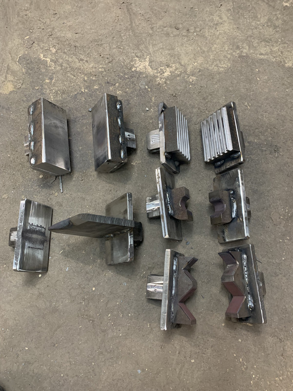

I’ve been working on some new dies for the forging press.
I made a set of full flat dies, ladder dies, rounding dies, squaring dies and dies to split damascus for a feather pattern.
Ive gotten to use a few of them and wish I would have made these way sooner
Nice. I'll take a set of those squaring dies. :D ;)
