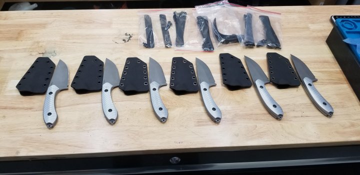

What is that handle material?I managed to get these fixed blades done last weekend. I haven't made one in quite some time. Also my first time using nitro-v. Back to folders for a bit but I definitely want to make more of these.
6061 aluminumWhat is that handle material?
Those are cool. Look very production!I managed to get these fixed blades done last weekend. I haven't made one in quite some time. Also my first time using nitro-v. Back to folders for a bit but I definitely want to make more of these.
Thanks.Those are cool. Look very production!
