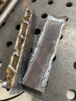

These billets have been run once and now are stacked for another squeeze.
I weld the seam all around so I don't have to mess with flux.
A couple of them are kind of explosion low layer pattern.
The bars are squared up on the mill and cut at something close to a 45. I used a TIG to tack them together.
For the Ferry flip billets I MIG welded thin sheet metal jacket on top and bottom and then MIG welded the side seams. Again, no flux.
