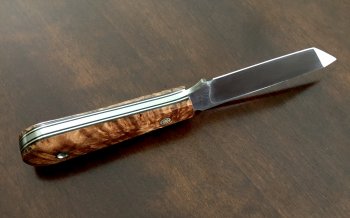

Bit of a different one for me. I’ve never done a tanto before, and I usually don’t leave bevels the way they come off the grinder. In this case I thought the contrast of the vertical scratch pattern on the bevels and tanto made for crisper lines. The single bevel grind made for a deep plunge. I like it. Handle is redwood burl. Steel is AEBL.
Edit: Ugh. In a big picture you can really see your dirty fingerprints... I'd take another but I already shipped it today. :(

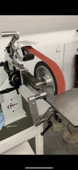

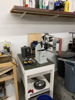

Yeah!!!!
That’s awesome Jon! Looking forward to seeing the work you produce with it. That set-up will be a dream to work with.

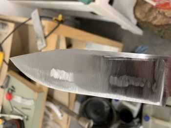

Heck of a learning curve, found a burr on my platen when I switched to a J weight belt gonna have to clean it up until i can get a glass platen rigged up
