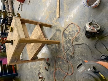

Built a bench for my KMG-TX whose arrival I am eagerly awaiting!!!

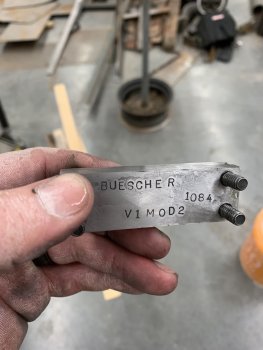

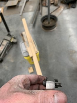

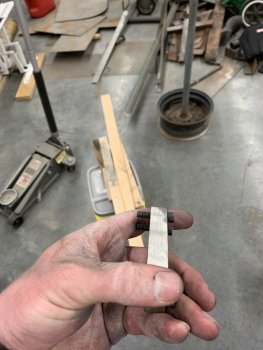

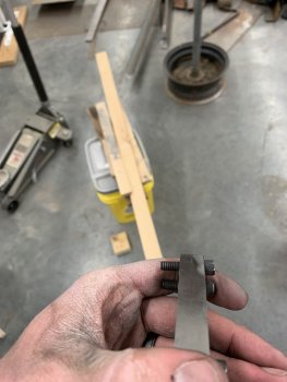

and I made a file guide out of .270x1” 1084

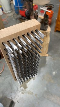

and my new wire brush arrived

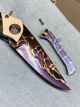

Tried some Oxynate 7 bluing salts.
The colors came out but only barely. This was likely my fault. I need to practice with these salts a bit more.
I sanded off that finish and went to the Nitre Blue Salts and got much better results.
This is san-mai piece with lot's of nickle powder and foil. The metals were mild, A2, 01 with a 1084 core.
Lot's more work to do on this one but it's coming along.
