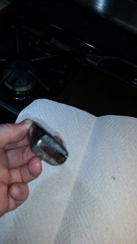

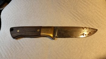

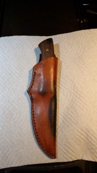

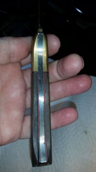

hi. sold a knife to a guy just over a year ago, as a gift for his nephew. yesterday i got an email saying "there is something wrong" with the knife. today, i went to see about the problem - i'm thinking what manufacturing defect has reared it's ugly head - would be my first such complaint. well, the story i get from this guy, is that his nephew was kayaking, and the boat overturned. the knife is in the water for "about 20 minutes" he tells me. well, i have my doubts. i think that the knife spent more than 20 minutes wet, and that the owner applied some heat to the handle to dry it as well as the sheath, and the damage you can see is what resulted. now, i'm not sure, and am taking the guy at his word. i told him this is not a maker's defect, but i would clean up the knife and try to "re-glue" the handle to the knife. I'm interested in any knowledgeable person's opinion about what they think happened to this knife.

Wow, applied heat? Who knows how hot and how long. In fact, if I were going to remove a set of scales, that's probably what I would start with, heat. If you don't mind me asking, what type of wood and which epoxy did you use?

I would guess that the knife was kept in the wet sheath after he got it out of the water. If the knife was dried after coming out of the water I don't think it would have the rust that it does.
What is the liner material? When I use liners, I drill as many holes as I can get in the liners so there is a lot of epoxy contact between the blade and the wood scales.

I did some pretty extensive testing on a couple dozen adhesives some time ago. After I got done I threw away 6 new, unopened packages of Devcon 2 ton epoxy due to the high failure rate. In this case, I'd guess it was a combination of the heat and adhesive used. To be fair to Devcon, heat fails nearly all epoxies. There are some epoxies that can take higher heat than 200F but not many.
Is the red liner vulcanized paper?

It appears to be vulcanized paper and that can draw water in and swell. It does it very slowly though and 20 minutes soak time wouldn't be an issue. To test this, drop a scrap in a cup of water and see how long it takes to soak in. I still use it knowing this because nothing looks as bright as it does. I do seal up the exposed seam with thin superglue. Some guys refuse to use vulcanized liner because it can be hygroscopic but I'm not scared (lol).
I'd guess, as others have, it sat in a moist sheath for some time and everything swelled up. Water may be the most potent energy force on earth.
As for the glue, I use Gflex or Blade Bond. Both are designed to better handle sudden shear force.
The most important part of any bond is not the glue, it's the surface prep. Either sand blast the surface or rough it up aggressively with a 40 or 60 grit abrasive. I have destructive tested vulcanized liner glued surfaces many times. It does not bond well at all with out significant surface roughing.
When manufactures test their adhesive they use sandblasted metal coupons because it bonds the best.

This is definitely not 20 min exposure. Thoroughly waterlogged, that’s what happened. I think you should at least try to charge them for repairs if you decided to help and restore the knife.

I suppose that depending on where he was kayaking, the knife could have been getting wet before it was completely submerged. If the scales weren't treated, moisture could have been seeping in this whole time. Looks like he probably heated it pretty hot and quick. The rust on the blade could have happened if left in the wet sheath for a few hours.
