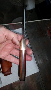

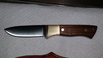

Gliden07, I agree; stored wet, at least! the guy bought 2 knives from me, so I'm doing this for him as a favor as well as for my karma. took me about 30 minutes to clean it up. no, i don't believe the story, haha. just trying to be a good guy, and maybe he'll buy another; we'll see (hmm...do i really want this guy buying another? not sure). BTW, here's the knife as he will get it back tomorrow; not new, but cleaned up way better than it was, especially for free.. Even sharpened it for him. :)

Chris, yes, kydex would be a good option; that is what I use for my fillet, and some oyster and boating knives. this guy never mentioned the knives he boughtfrom me would be used out on the water.
Michael, good relations to stand behind your knives. Not only does the sheath show water damage but the heel of that knife laid in contact with water for a while!! Look at the area I circled and it took a while for the water to draw up enough to cause the liner to turn black from the walnut!! I think I would tell him that in the future water damage is on the operators back, and you will no longer warranty against any water damage!! The operator is held responsible for taking prudent care against water damage, to the knife or sheath!Water damaged.jpg
C, oh yeah - this is a "one-off" on repair for non-maker defect, operator negligence! When I sell a knife, I give the buyer one of my homemade cards with what material is used to make the knife, as well as an "information" sheet of do's and don'ts to maintain the knife in good condition.
