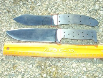

Looking good so far, the only thing that I see, is that your plunge lines are moving a little far into the ricasso area, and are washed out and not defined, unless that is your intention, then that is fine. What type of grind is it going to be? Looks like a convex. It is good to see that you have been doing some serious thinking and research. Keep up the hard work.

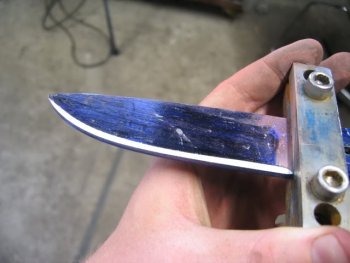

Instead of telling you, that I think I have it right, I thought I would take some pics that hopefully will allow you to see it. This will probably take a couple of "Posts" so if you read this before I get the 2nd post up wait just a minute or so while I load the second post with pics.
A shot of the spine first..................
Now a shot of the edge, looking straight on....................
Same shot slightly different angle......................
My "Lovely Assistant in her "Barn clothes" holding it the tip toward you.........
Same shot, slightly different angle.............................
Again, this time tip up,edge toward the viewer....................
I hope this helps clear up any questions....
pocomoonskyeyes
Not real clear shots.......... Let's see if I got any that are better..............
Hopefully these are well enough to help you see more clearly. I think that it looks pretty even. But you might be able to tell more.

I scattered the work over several days, and only worked incrementally. My first concern, was with having the cutting edge centered on the blade. So what I did was make my initial grind short and steeply angled, just to Center the edge. Even this was done in increments, constantly checking the progress(after each pass). From this point(once it was centered) I Moved my grind further up the blade, towards the spine. Then I worked on the tip/point, or clip. It is actually sort of a cross between a drop and a clip. The very tip is slightly rounded away from the Clip,toward the edge. This is only in the last 1/2" toward the tip. Personally I would class it as a drop point more than a clip. Even though it is not as pronounced as most Drop points. There is more of a "roundness" to the clip. The most time consuming part of the work IMO was in keeping the sides ground as evenly as possible. MUCH eyeballing is /was done here.
My advice to anyone making there first blade? Go slow, work in increments. CONSTANTLY check your work! But two things I would say are really important. Go easy on yourself, don't be too critical of your work, you are just learning after all. Still try and do the best you possibly can. The other thing? Have FUN!! Enjoy what you are doing! I think you will make better progress if you have fun with it. Just my 2¢ worth, and what do I know? I'm just starting!!

First off let me say I am new at this too. When I post WIP photos I like something more than "looks good" So with that in mind...
I was looking at your grinds and thought I would give a little newbie advice.
On both blades there is no real defined plunge line. The grind just kind of washes out and goes on back into the handle area.
I have edited your photo with a black line where I think the grind should end and be defined. I also blocked an area in red where I think the grind goes back to far in the handle area.
A good way to define these areas when grinding is to have some type of device like the one in the picture below. You can also hand file the plunge in and then grind forward from there.
I hope this is helpful to you. If any of you more experianced guys see anything wrong in my advice please comment. I'm still learning too.
Thanks,
Chris

Thanks CD!! I know more now, than I did before you posted!!2thumbs
Anyway, it may be "Imperfect", it has flaws. But these 2 knives were meant for me to have. They won't be sold OR given away. They were quite simply "Learning Projects". They were meant for nothing more, than for me to learn how to make a knife. While they are far from Perfect, I am Fairly pleased with them (yeah, there's all kinds of stuff I see now, that Could have been done better) But I learned and THAT was my ultimate goal with these two knives. I broke the Lacewood scales,(another learning point) Trying to pin tem to the Bowie. By far, I prefer Stabilized scales. They are Much easier to work with, for me. So I had to re-do the Bowie,that is why I have no pics of it right now. Maybe tomorrow, or Friday. Without anything further, here is my first Completed knife, the Nessie............
