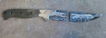

Here are my old school inspired knives. And my second and third sheaths. Funtional not fabulous sheath. Lol

Walt will this help?2 piece fighting knife.jpg This is a new pattern for me. Its a two piece tactical knife. I have about six hours into it at this point. When this came out of the fire, I had to tweek it and it didnt like that. I am still learning like most of the people who come to this sight. The trick is to not get down on yourself. Its a learning curve. Sometimes fun sometimes not so fun. Kick back and enjoy the ride. It will be worth it in the long run!
Steve
