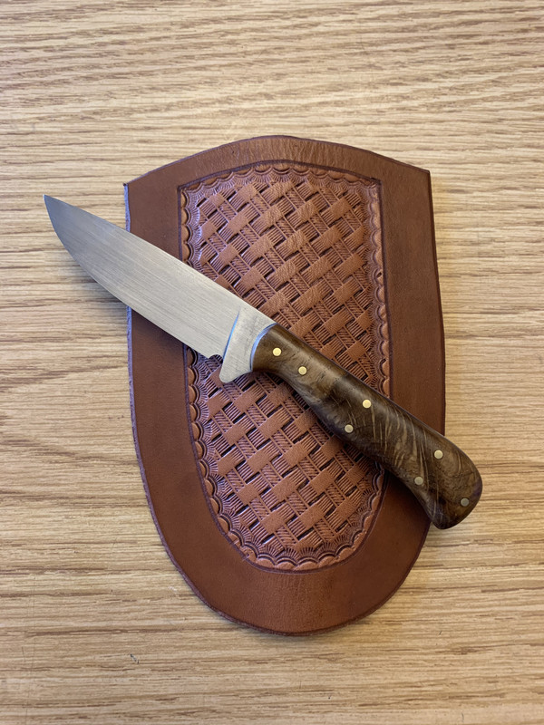

Simple sheath build along

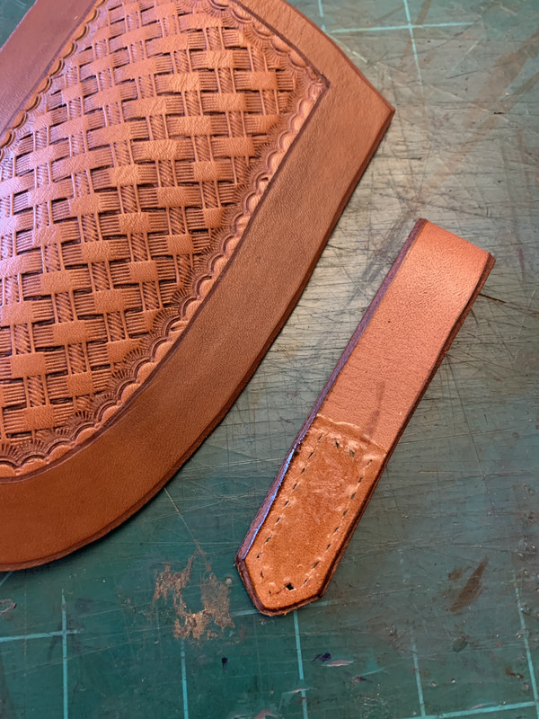

Chris - I struggled a bit with this issue. Heck, I still do. I am going to respond to this, as I may end up braiding the edge of this sheath. If I use thread, I will show you how I attempt to overcome the matching up issue. Otherwise, I cut my groove line for the stitching on the front side of the sheath. I do not cut the back side. I then use a diamond shaped pricking iron for setting all the necessary holes. Make sure you are perpendicular on each setting so the holes stay lined up on the back side. After cutting all the holes, I will cut the groove line for the stitching on the back side of the sheath and use the holes as a guide to follow. It beats trying to blindly find the groove line on the back side of the sheath. More often, you miss at least once. I hate that!!

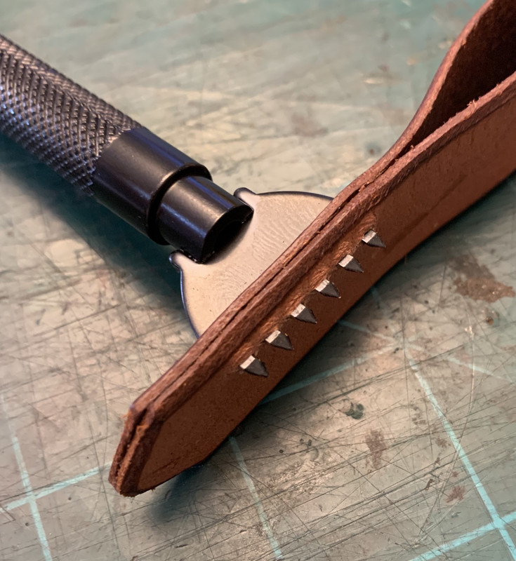

Sorry Chris, I misspoke. I use a diamond hole chisel not a pricking iron. Brain fart! It is a cheap adjustable one from Tandy. I used to drill holes, I switched to a chisel set. It helps me keep better spacing. Also helps to keep everything in line.

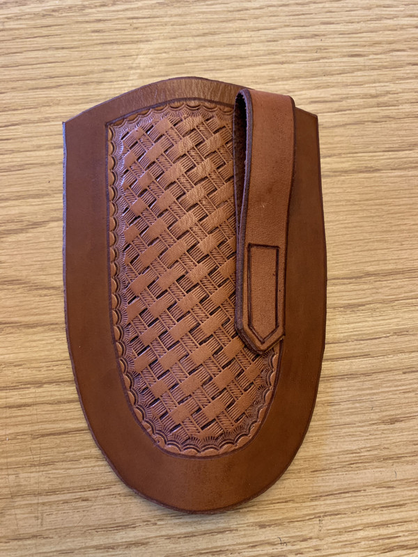

After stitching, I will need to make a decision on whether to stitch the edge or braid the edge. I planned on stitching but I want to braid. This is the welt. I made it thicker for braiding. If I stitch it will get thinner. You just need more space for braiding because the hole is so much bigger than a stitching hole.
To set the holes, I have three choices with the chisel. Small, medium or large spacing. Unfortunately, small worked out best which means I get more stitches.
Just line it up and hit with a mallet. Make sure it is straight up so the holes are straight.
Chris Railey - Back side. If I was going to stitch, I would use the groover and just follow the holes. That way, I cannot miss the groove on the back side. I hope that makes some sense for you. Let me know if I need to explain it better.

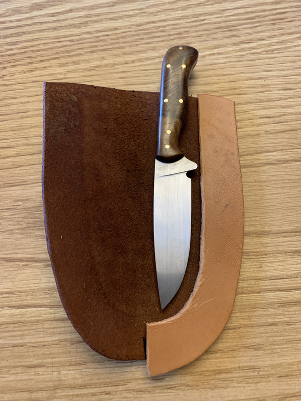

A little bit of barge cement, let it get tacky, set it into place, punch the holes through the shield, and start stitching. Easy peasy.
And we are off. Some time ago I came across a killer deal on close out. I bought thread for $1 a pack. I think I bought 3 each in black, brown and tan. I should have bought them out. Duh!

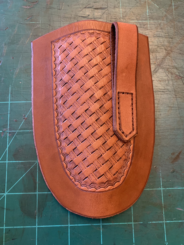

All stitched. I cannot sing the praises any louder for the chisel. I used to drill each hole with a 1/16 inch drill bit. I never got the hang of it and always struggled to make the stitches look decent. I got the chisel after a leather buddy suggested it. 10x better in no time. I will never go back.
