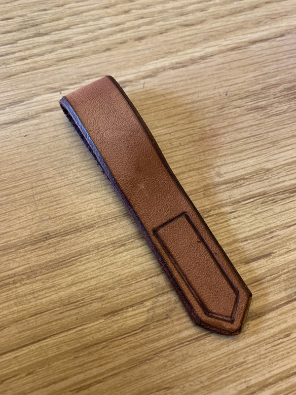

I will start the coloring phase. I cheat. For the grooves I use a sharpie. Just follow the line. Pretty simple
Here are the colors that I have picked. Since the knife is two toned-the sheath will be two toned.
Solid light brown edge and antique mahogany centers.

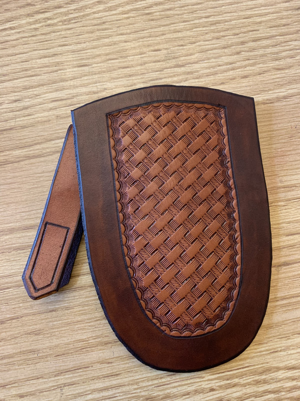

I use a q-tip to apply the light brown dye around the edge and on the inside of the sheath. Then I use a heavy shop rag to apply the antique finish all over each side. Turns out like this.
This is great Dennis! I'm not sure I'm understanding which parts you dyed with which dye. Is the border the mahogany antique and the basketweave the lighter brown?
