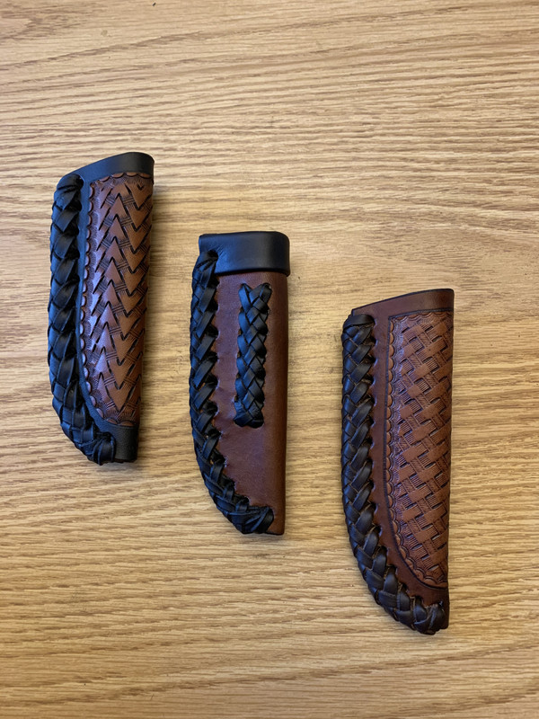

Last picture. I think. We’ll see.
But, here are the three sheaths that I needed to build. The example from the WIP is on the right. The other two are from the exact same pattern. My point in posting this picture is to show subtle changes can make a big difference in the end product.
You do not need to do the exact same thing, over and over and over. Similar is good, but exactly the same is boring. For me it gets monotonous, at least for me. Variety is the spice of life and it keeps it interesting. With leatherwork there is always room for changes, color, texture, technique, etc. Because there are thousands of choices.
Feel free to experiment. Free your mind and get creative.
