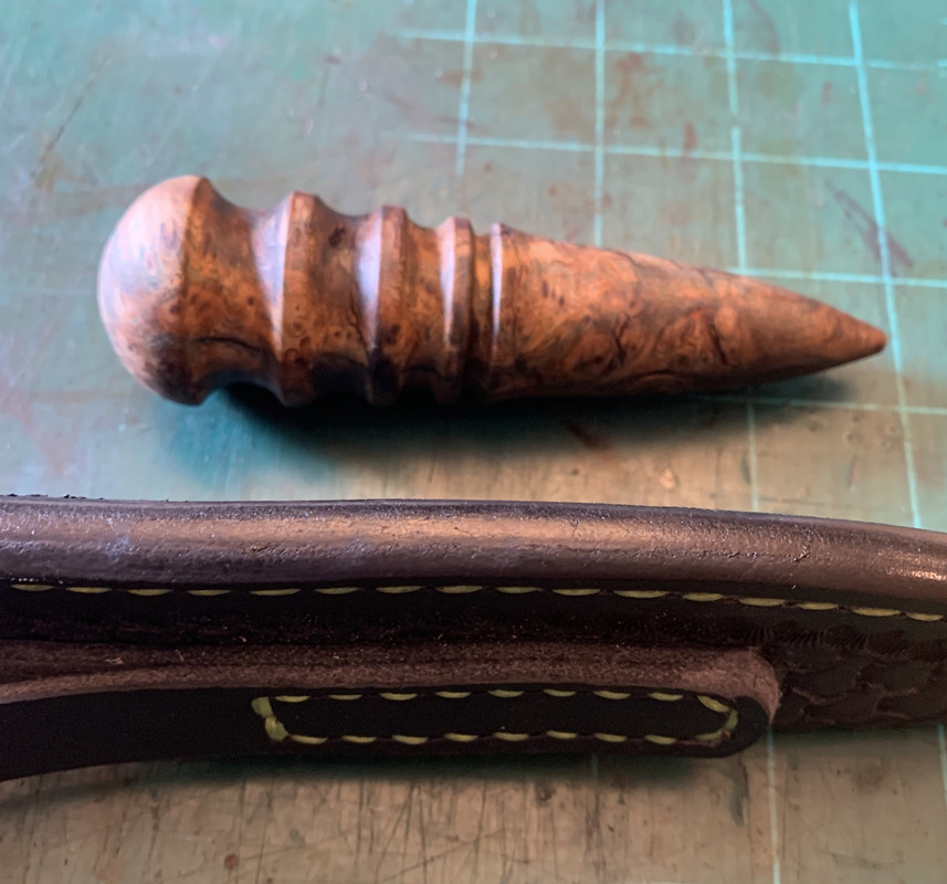

Time to slick the edge. I use plain old tap water applied with a q-tip. Above the sheath in the picture is my favorite slicker. Siberian Elm Burl. Works great.

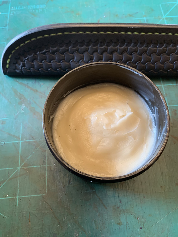

The last step is sealing/protecting the leather. Dozens of choices. Leather sealer, mink oil, waxed of all kinds. Too many to mention.
The two that I use are called Tan-Kote and Obenaufs leather protector. Tan-Kote can be found at any leather store. Obenaufs can be purchased at Cabelas in the leather boot department. I love the stuff.
Kind of a waxy paste. Just smear it on your hands to warm it up. Then slather it all around on the leather. Concentrate on the cut edges, inside the belt loop, and in the throat of the sheath. Let it dry and buff with a paper towel. Add a second coat if desired.

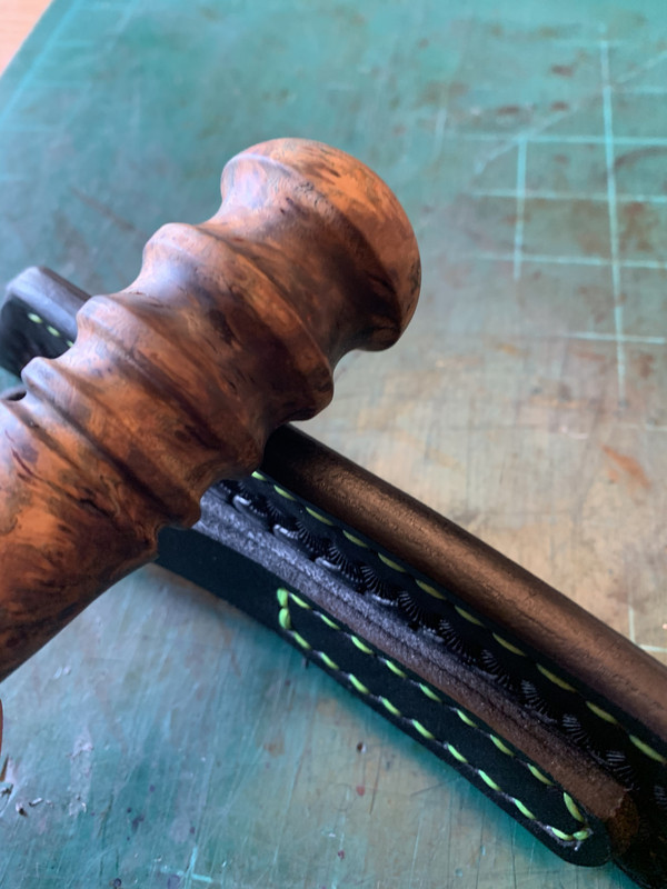

How do you use the slicker? Do you actually 'burnish' the edges? Or do you press them into those grooves around the slicker? Very cool
Another excellent question. You place the edge slicker on the edge like in this picture. I wet the edge with water first then rub/stroke the edge by vigorously moving the slicker along the edge. Forward and back motion. You are attempting to compress and form the edge fibers of the leather. Make it look uniform.
Dennis in the photo you have the burnisher at a slight angle. Is that just for the photo or do you burnish at that angle as well? The reason I ask is you mentioned you burnish 'vigorously'. When I've burnished vigorously I end up with a lip on the edge. So I go very gently to avoid raising an edge. Or maybe it's just my crappy leather?
Dennis Morland
sean - pretty much straight and perpendicular to the sheath. I try to use friction at it finest to set the edge. A little bit of water and rub back and forth with some speed to it. I did use the biggest groove and the second biggest groove. If I get a lip, I straighten it with the opposite pointy end and go back to rubbing.
Thanks Dennis. That really helps. If I have time I'll be finishing up a sheath tomorrow and I'll try your method on the edge.
