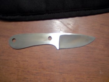

Well, I ground my first blade in the new shop today. I actually started three of the same pattern, but one blade had a bow to it and I over ground another. My intent was to save the bowed blade as a pattern, but as soon as I get a chance to straighten it I will and use the over ground blade as a pattern in the future.
This blade is hollow chisel ground from 1/8" 1095 with an OAL of approximately 5.75". My intent is for this to be a neck,utility knife. When complete, it will have black linen micarta handle scales and ss tubing with a dual carry option (neck, Molle-Lok) Kydex sheath. I'm not real pleased with the placement of my holes. I'm thinking that I may change the placement by just using ss pins as opposed to tubing. Then again, I may just wait to correct it on the next one.
Here is the pic.

Nice shop. must be nice to have some space to work in. The blade looks great....keep the Pictures coming....2thumbs
Here is the pic.
From the looks of your work, I don't think you have to worry about your shop making it, murph. 2thumbs
Nice shop and nice start, fella!
