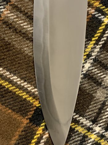

Hello brad and stephen , Nice work Stephen . brad ,I noticed your post about 5160 . You can do a fairly nice hamon with it . Quench is 1 sec in water and then right into oil.
