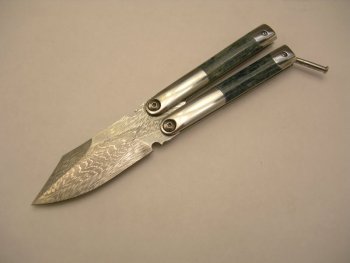

Ikoma and Korth came up with an adjustable latch for their Pulsar project...
Only a handful of these have been made to date and this was never perfected.
Les George
Admin - Founding Member
That is pretty slick too, what isn't perfect? thread in the adjustment, tighten the jam screw to hold it there.
