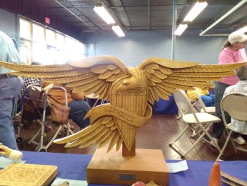

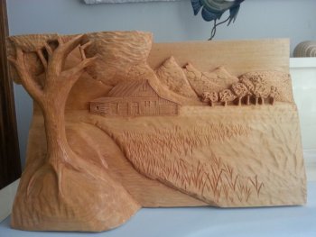

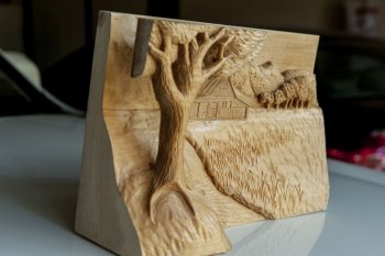

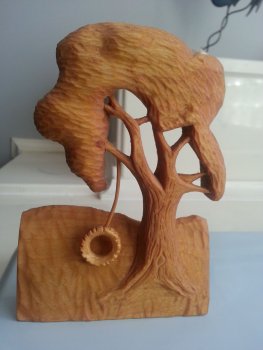

Carvers can have several hundred tools, which probably includes a knife like the one I showed. But the typical carver will have many handled knives with different blade shapes designed for different types of cuts. There are multitudes of two-handed tools, which are used in all types of carving and sculpting, but also used in architectural carving, i.e. scrolls, etc. When carving, either in the round or low and high relief, a carver might end up using 20 or 30 of those tools to complete the piece. The knife I showed in this thread could be used by itself to carve characters or any number of in the round items. Typically, a carver using just one knife would be carving folk characters or whittling projects. So the question is kind of like me asking you to show me the tool you use to dismantle a combustion engine, if you get my drift.
I probably used 30 or 40 different carving tools on the Eagle. 5 or 10 on the Tree and Tire Swing. 10 or 20, plus a number of Dremel tool points on the Tetons and Multron Barn. But can't think of a single carving I've ever done with just one knife.......................................wait, I'll take that back, there is a practice project that most any carver has done called a Ball in a Box. The idea is to carve it with just one tool to practice using the knife for many different cuts. It's kind of like an opera single sings scales 4 hours a day throughout their carrer.

Those are beautiful. The eagle is amazing but I particularly like the tire swing. That's great you teach, i not sure there is anyone in RI that teaches this but maybe it's a hidden art.
Thank you, Sir. I really don't get to carve much for myself. Mainly my energy is spent teaching. But I'm looking forward to building a reputation as a good carving knife maker. We'll see.
